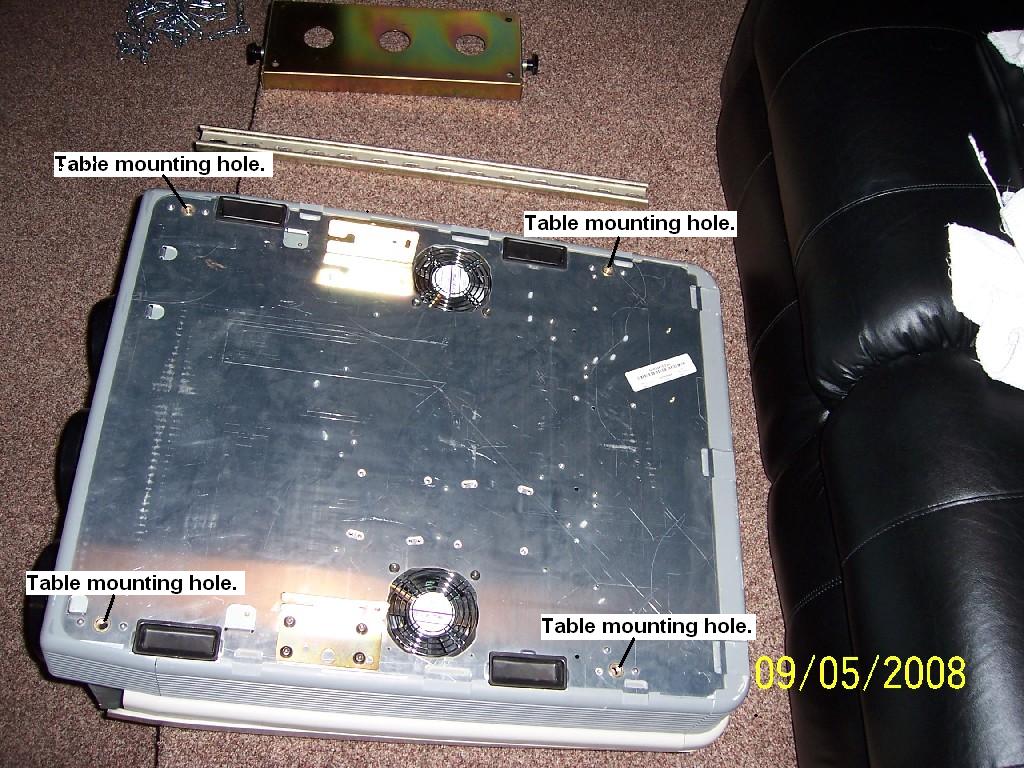

Can I use the table mount screw holes (normally used for leveling stand-offs) for the reverse function and use them for ceiling mounts? I would like to attach uni-strut to the bottom of the pj using the table mount screw holes.
Is there enough base plate (?) support in the case to do this?
Or, must I use the mounting holes as the pj has for a factory ceiling mount plate?
thanks.

I'll wait for someone else to confirm it but my gut feeling is that the NEC PG cannot be mounted by the leg holes. I remember someone had a projector fall when it was mounted like this (pretty sure it was a PG or XG)

I think I saw pictures of that. I would hang it from the factory designated holes.

I would definitely ONLY modify the factory mounting plate, using the original factory mounting holes for it. Adapt that into a uni strut assembly. My 2 cents

DO NOT mount in those feet holes unless you are absolutely sure that each threaded rod is run up to the same length. Putting one corner in even the slightest bind can put enough tension on the frame to make it break one day. I have seen pictures of it before. If you have attic access then mount that unistrut across two or three rafters, drop the threaded rod through those, through the ceiling and into the factory mount. Let the unistrut and beams carry the load, not the mounting bracket.

If you mount the unit from the leveler holes you should use metric bolts. I installed a PGxtra that way with the proper sized metric bolts and it is strong and safe. Keep in mind though that a 3/8 rod will thread in but it is not safe in my opinion.

don't use those "foot" holes. You need _very_ little force to rip the threads out. They are only meant to withstand force pushing against the base, but not any force pulling at the base.

You have the original mount. Why even consider anything else?

lol I was wondering if anyone would ask... If I could use the table mounting holes, it would give me a little more flexability.
From the feedback, doesn't sound like a good idea anyway.

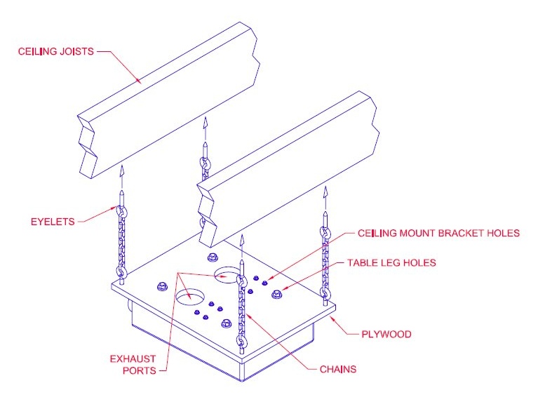

I mounted my PG9 using the table mont holes but I also used the 8 holes that bolt down the cieling mount.
My PJ is mounted flat to 1" thk. marine grade plywood and there are eyelets on each corner. I used a length of heavy chain on each corner. This method allowed me to raise, lower tilt skew the PJ to its ideal alignment to the screen. Im using the 11 degree mount method. I'll work on getting a pic today and post it.

Heres what I did

that's not good cooling wise.
The chips on the C-Drive and F-Drive use the bottom plate of the PJ for additional cooling.
With your mount the heat will no longer be transfered away from those chips, and that can lead to premature failures.

When you attatch the board to the bottom , there is about 1/2" gap between the PJ and the board. It just works out that way, du to the shape of the bottom plate. The cooling fans work as they should and also draw air between through the gap creating additional cooling.
