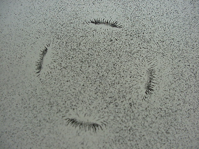

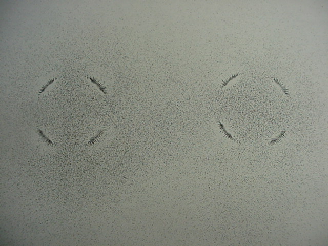

Some time ago, there was a discussion about astig rings and the possibility of making them or enhancing them and someone suggested showing the magnetic field with some iron filings. The idea was interesting and I was curious to see what the experiment would show. I don't think any pictures were ever posted, so I decided to give it a try. The only rings that I had available were some parts that I had saved from some Sony 10XX machines. The rings were placed under a sheet of thin white paper and dusted with powder from a Magnaflux kit.

Posted: Tue May 06, 2008 6:32 pm    Post subject:
Yeah i ahve been thinking about making my own 6 pole cpc magnets. CMJ did this by finding the feild as you have shown above then taking the one magnet out of the 4 pole that is "dead" with no magnatism then he matched the field from a know 6 pole configuration by placing rare earth magnets on those places to magnetize the rings. Not sure if all cpc rings have the same magnetism in the same set. What i mean i wonder if the first middle and last magnets all have the same pattern .

Posted: Tue May 06, 2008 10:57 pm    Post subject:
Wow, that's really cool. Looks like that is why stig rings are called four pole. The beam centering (flair) rings are two pole. They would show two of the groups spaced 180 degrees? The six pole rings (triangular spot correction) would show six groups spaced 60 degrees apart?

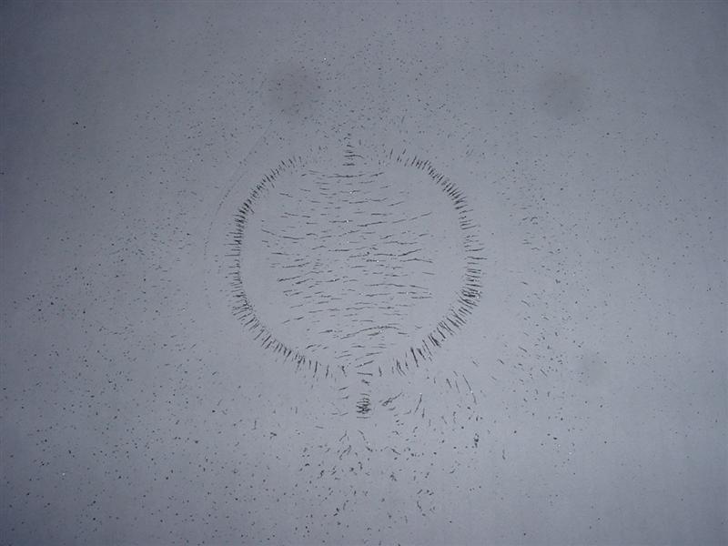

i did the same with a 2 pole
 Filesize:  60.45 KB
 Viewed:  15182 Time(s)

Posted: Wed May 07, 2008 5:29 am    Post subject:
That paper/iron powder works also if you have teared down those magnets..and forgot that what what was 2-poles and 4-poles Neutral Who didt that Question Me Embarassed

Joust
Your picture is interesting. Two poles are clearly visible, but the entire ring shows an effect on the iron filings and it also seems like there is a magnetic field within the ring. I have no idea what it means, but it is very different from the very clearly defined four areas on the Sony rings.

Posted: Wed May 07, 2008 12:18 pm    Post subject:
it is the magnetic field in the center of the ring that affects the electron beam of the CRT. if there was nothing there, it would have zero effect on the beam. the 4 pole has much more magnetic stuff going on in there.
what I did was put the filings on, then tap the paper lightly. the filings move around and line up along the magnetic lines better.

Posted: Wed May 07, 2008 5:53 pm    Post subject:
Has anyone tried stacking rings for stronger magnetism?
Posted: Wed May 07, 2008 6:02 pm    Post subject:
Yep thats what Chris from the frankenyoke thread has done he just took the center ring(not magnetized according to him) from I think current four poles and added the rare earth magnets in the right spots to make it a six pole. Now does it really matter where each pole ring is placed?
Yes it matters very much where the magnetized areas are, and no you couldn't convert a 4-pole into a 6-pole. You could turn a 2-pole into a 6-pole.
I don't have a chance now to draw pictures but maybe I can explain it:
Look at the 2-pole picture. One side of that is "North" and one side is "South." Imagine an arrow going from S to N. In each set of rings you have 2 rings. If you line them up so the arrows point in opposite directions -- N of one ring next to S of the other -- the magnets cancel out and you have no effect. If you point the arrows in the same direction, they reinforce each other and you have double effect. At positions in between you get between 0 and 2x effect.
The 2-pole has only one total "arrow" resulting from combining the two rings' arrows so it only affects the beam in one direction -- so you use it for centering. You rotate it to determine which direction you're pushing the spot, and adjust the rings between 0 and 2x to determine how far you push it.
A 4-pole ring set has 2 "arrows" in each ring, perpendicular to each other. That lets you affect the beam in two directions, so you use it to change the shape of the spot (turning an oval into a circle by squeezing more in one direction than the other). (I'm a little unclear on the exact mechanism of this one, because the 0-to-2x variation affects both arrows, not just one. I think there are 4 "arrows," 2 pairs 180deg apart, pushing in from 4 directions. You rotate it to line up the arrows with the long end of the oval, and adjust the rings to determine how hard you squeeze the oval.)
A 6-pole has 6 magnetized spots producing 3 "arrows" 120 degrees apart, which lets you control triangularity. You line up the "arrows" with the points of the triangles in your dot, and move the rings between 0 and 2x effect to determine how hard you squeeze the points in.

Joust
Joined: 05 May 2006
Posts: 2429
TV/Projector: Marquee 8501LC
Posted: Fri May 09, 2008 3:47 am    Post subject:
Gary
yes you can.
BUT first you have to Erase the magnetic field by using a bulk tape eraser.
the material is treated exactly like the tape in a reel to reel and cassette tapes and video tapes.
outwest
Joined: 17 Dec 2006
Posts: 212
Location: Honolulu
Posted: Fri May 09, 2008 6:41 am    Post subject:
Your idea of the ring around a tube of paper is cool. I will try to see if I can make somehing up that will show something useful . It might be tricky to get something workable that I can get a picture of. It might take me a couple of days. I am up to my clavicle in alligators at work right now and I also have a mainland visitor.
I have been thinking about the picture of the two pole ring that Joust posted. It is not at all what I would have expected. The four pole Sony rings fit my mental image of what they would be. I expected the two pole to be very similar, but with just two areas of magnetism. The filings on the Sony rings seem to come up and curve to the outside of the ring like the north pole was on one side and the south pole was on the other side. My vision is that the electron beam goes down the center and is positioned or shaped by the influence of the surrounding magnetic fields. It seems like the definite magnetic field lines within the ring in Joust's picture would mess up the beam, like sticking one's finger into a stream of water. I am operating from a position of complete ignorance here!
