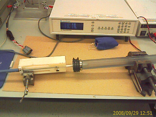

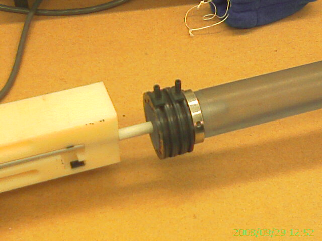

As a 'Fast and Dirty' first test I left the 1208 CPC pack intact (therefor expected overlapping fields) and slid the probe in and out (bow chicka bowwow Razz ) until I hit a max field, then turned each set of rings.
Predictably, the dead rings did nothing.
The "tube end" ring had four distinct lobes (that is, +/- field transitions,) and max gauss was measured at just under 10 gauss when manipulating the 2 pole rings' relative position (each half of the 2-pole relative to the other, that is.)
The setup was X&Y sensors co-planar with the rings, and Z axial to the centerline of the rings (aka "electron-beam eye's view.)
It was the X&Y that measured excursions of field strength, as predicted above.
Close-up of probe interface

Overall F&D setup
 Filesize:  73.7 KB
 Viewed:  12361 Time(s)

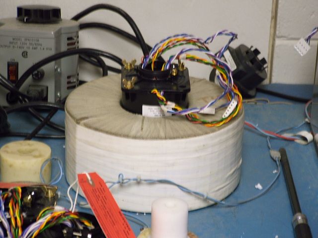

Very interesting stuff. I would like to know how to make 2 pole rings for beam centering or just plain old raster position. I played with it a little bit but don't think the equipment that I have access to is right for charging rings. It works fine for focus magnets.
Scott
 Filesize:  56.71 KB
 Viewed:  12323 Time(s)
Scott
Hey Scott is possible to make one of those? it looks like a transformer coil powered by a variable transformer?
