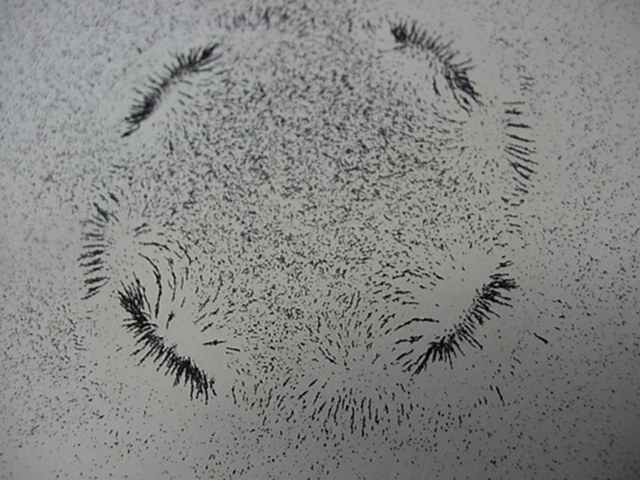

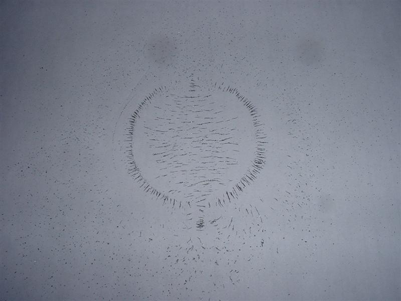

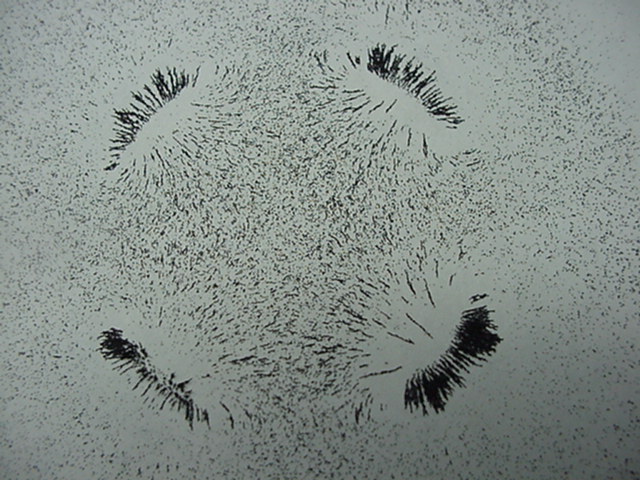

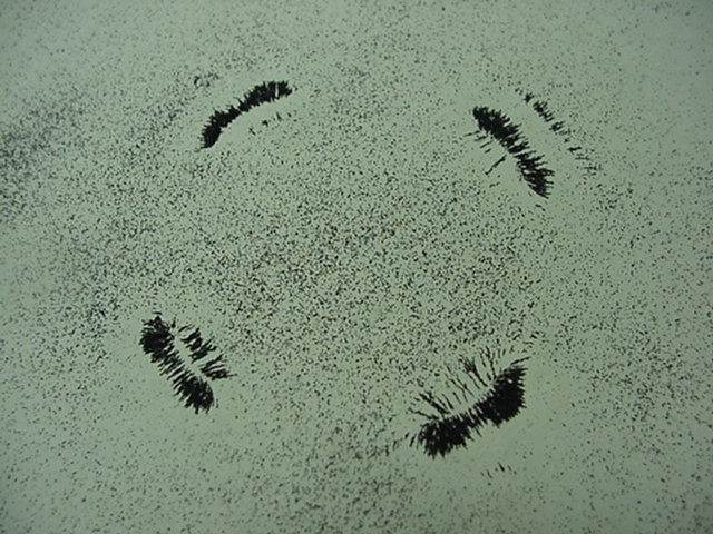

I spent a little more time with the Sony rings and some iron powder. In the 1ring picture, I tapped on the paper to aid the powder to migrate under a weaker magnetic force and there was definite evidence of magnetic lines arcing from one strong field to the adjacent strong field. The lines were pretty weak and the picture doesn't do a great job of showing them, but they were definetly there. On this ring, there was never any sign of magnetic lines right in the center of the ring. The powder would just move towards the closest of the four strong areas.
What I found interesting was that when I stacked the two rings together, aligning the paint marks as they were installed in the projector, the lines from one strong area to its neighbor disappeared. I repeated the test a couple of times and there was no evidence of the interconnecting lines.
Joust, thanks for the suggestion and the motivation to explore a little more.

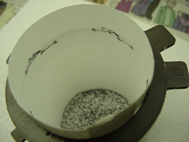

Athanasios, I have been thinking about your ideas on the beam being pushed or pulled. My head hurts! I am simply not smart enough to offer anything useful here. I did try making a paper tube. The results were what I would have expected. Perhaps the setup needs to be better to show something more.

Neat!!! See I think the beam is pulled to the center by the forces of the magnets pulling at least on that ring in the pic( I assume its just one magnet not the pair). Now if there were both rings on the tube in the proper "null" position my theory would be no powder should stick to the surface of the tube as the opposite polarities should be "on top" of each other. So when we move the rings around the tube the associated"released" magnetic field of the rings would affect the beam . and as the electron beam passed each ring the type of magnetic field would control the beam each in its own way. So this is why the 2 pole is at the end of the CPC path that the beam travels, it was shaped at first by the 6 and 4 pole rings and the two pole adjusts its final position on its way to the other magnetics.
what do you guys think? make sense?

Yes. The tube picture is with a single ring. When I get into work in the morning, I will see what happens when there are two rings on the tube.

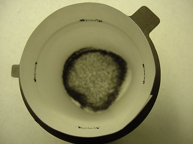

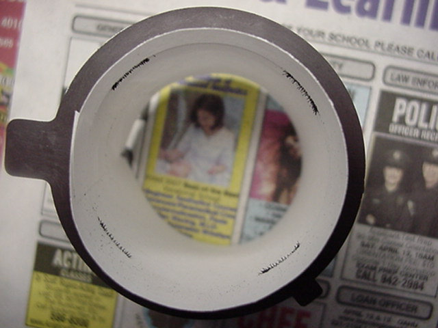

In the picture tube2rng, the rings are in the null position and they are tight against each other as they would be mounted on the tube. The powder does stick, but the attraction is quite weak. I had to use a lot of powder to get some to remain. In the picture tube2rn, I offset the rings slightly and the magnetic field became noticeably stronger. The filings would stand up a little where in the picture where the rings are in the null position the filings were mostly laying flat.

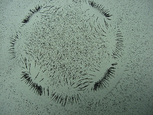

In the picture 2rnga, I layed the rings flat again and offset them slightly. Magnetic lines became visible, making a shallow arc into the center. In the picture 2rngb, I moved the rings to the maximum offset and the magnetic lines became stronger and made a deeper arc into the center.
Moving the rings in relation to each other seems to control the strength of the field and moving the two ring pack as a unit would then control the direction or angle of the effect of the field. Would this be a fair conclusion?

Yes that would be my deduction as well, that is why you have to move the rings around together to a point where they do not affect the beam, then you move one or the other to shape the dots. This visualization helps a lot in understanding how it all works.
