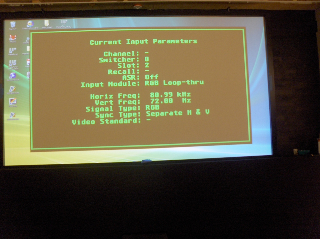

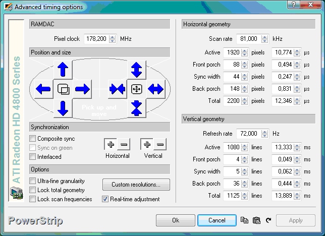

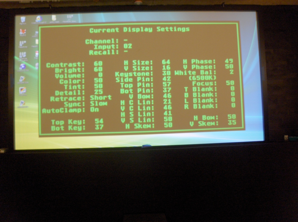

Posted: Thu Dec 04, 2008 4:33 pm    Post subject:
My settings:
 Filesize:  155.26 KB
 Viewed:  4910 Time(s)
 Filesize:  314.22 KB
 Filesize:  306.69 KB
Posted: Thu Dec 04, 2008 4:45 pm    Post subject:
Ok first try changing the uS and the mS ont he Horizontal Front porch,Sync width and back porch so they are all above 1,000. If that doesnt do it,
then add more pixels to the front H porch and H Sync Width.

I tried you settings Athanasios, but It didn't help much, other than it reduced the image size, and changed my refresh rate.
So now I have moved my PJ a little back, and uses a little less of the raster to the image, so that have reduced it to an acceptable level. It's not gone, but less visible now.
Thanks, Morten.

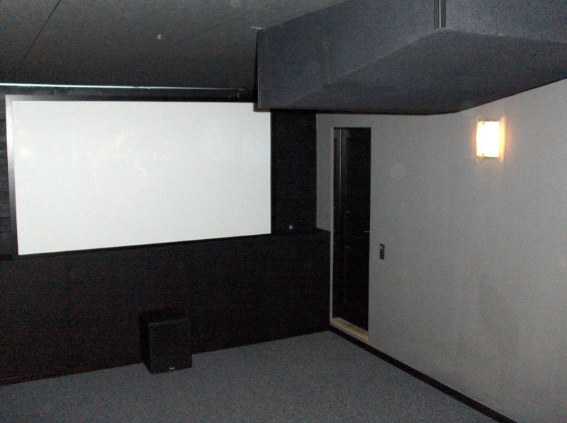

Posted: Thu Dec 11, 2008 7:16 pm    Post subject:

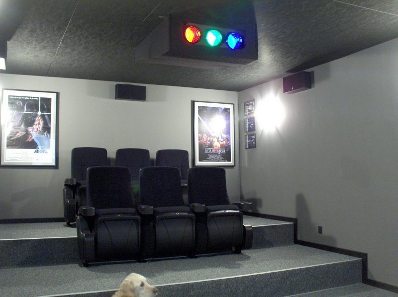

Hi guys,
I just wanted to post some pictures from my new HT room. It's almost done, I just need some curtains up by the screen.
Sorry for the image quality, bad camera.

if i was you i would buy more speakers in the back i would use sex speakers and i would buy more subwoofers
but whats me i use sex souroundspeakers and four subs with two teninchers in each sub

Posted: Mon Dec 29, 2008 9:39 am    Post subject:
Thanks for your reply Michael. Well for me the 6.1 system works fine. And believe me, the "small" SVS PB10 can actually shake the place up pretty well Wink
