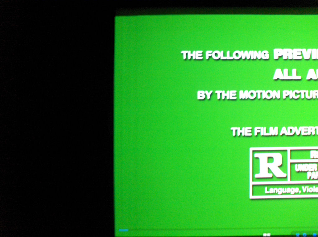

Can any of you tell me what those lines on the left side of the image are? They appear on all three tubes.

That's Raster Ringing. The image is too far to the left in the Raster (Raster is too far right really), or the Raster is too wide (pj too far forward), or the retrace is set to long instead of short (I think that the setting on a Marquee), or there's some adjustment on the HDM (dunno just guessing here).
Good luck with that....http://www.curtpalme.com/forum/viewtopic.php?p=82236&highlight=#82236

Try moving the whole raster more to the left on the tube face and then use phase to center the image. Some calibrators use this trick to eliminate that. I think it can be caused by using the H size too much. You may have to then physically move the PJ to get the image on the screen centered, that is turn the PJ left or right to center the image but then you will need to do geometry again. thats why its best to have it on the floor first and get it all going right for a few weeks before mounting. i bet the raster was off center
when it was on the floor and then when you put ti up on the cieling you need to shift the image the other direction to get it back onto the screen. then you got the ringing.
I know, i did the same thing. After i pulled the my entife pulley mount off the ceiling, I turned the PJ upside down on a table and centered it there this time the center of the green tube was dead center with the screen, i thne did the set up with it upside down, i had to leave the front of the edge a bit to get to the bolts and it was propped up a bit too. but it took a lot of time but i was able to get rid of the ringing.

The only physical option I really have with the PJ, is to pull it a little backwards. Athansios, I have moved the raster, and centered the image with phase, the problem was much worse before I did that.

it has to be timing issue what is your source?
Thor
Joined: 09 May 2007
Posts: 75
Location: Denmark
Posted: Thu Dec 04, 2008 12:20 pm    Post subject:
HTPC - Marquee VIM(not 1.3 HDMI) , 1080p 72 Hz.
Mark_A_W
Joined: 15 Mar 2006
Posts: 3068
Posted: Thu Dec 04, 2008 12:49 pm    Post subject:
Please post your timings.
You may need to add more porch pixels, and push the ringing out of the visible area, into the porches.
What is happening is the beam is oscillating after retrace - it's speeding up and slowing down slightly, which leads to the light and dark bands.
If you reduce the width by ~10%, does it disappear?
My XG does this a bit too, because I have pushed the width a bit too much. I need to pull the projector back or add lots more porch pixels if I really want to fix it.
