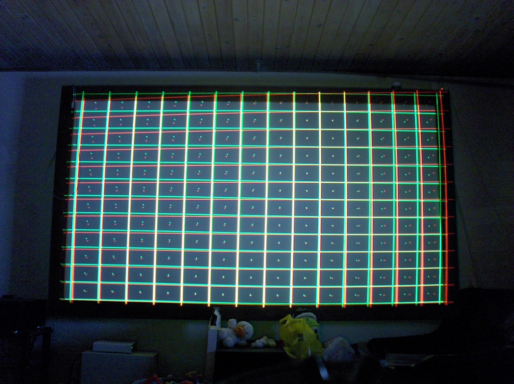

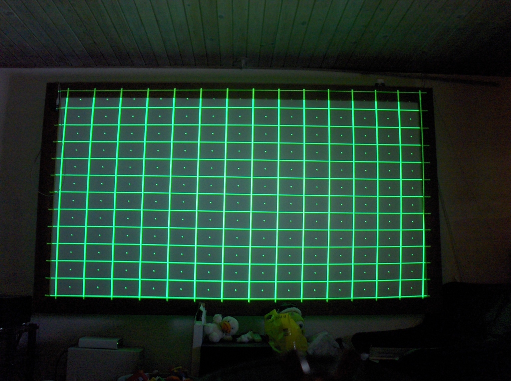

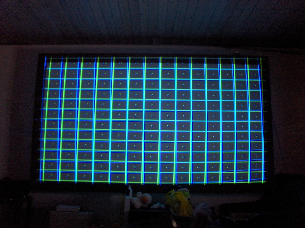

Hi Guys,
I'm playing around with my new 9500LC Ultra, and wanted to see the image quality on this beast, although it's not going up on my HT room ceiling before in a couple of months.
So I have placed in on a table and done mechanical setup on it, and done a coarse green geometry on it, so that's fine. But the red and blue crosshatch look like crap on green, and even though I can set it right by the convergence, I feel I have to push it too far to do it.
Especially the red looks funny, I have never had these problems on my Barcos. Do I have to get my hands on the scan yokes or any thing else dangerous?
When I turn down the contrast and look directly into the lenses, they all line up beautifully, and looks very much the same, but not on the screen?
Any ideas?

Red and blue deflection coils need to be tweaked.

Welcome to the world of LC and stepless Schempflug! It's a lot more complicated than an AC machine. I assume the Barcos you came from were AC.
Assuming your mechanical alignment is right on, that's about what a beginning mechanical setup should look like. The blue and green will always have a bunch of distortion and lack of horizontal focus the green won't have. Looks like you need to level the deflection yokes and then work on scheimpflug. Red looks way out, and I can't tell on blue. Once you have both of those done, then you can start working on geometry. You also need to make sure you've centered both rasters on the tube face.
Did you use string on the screen to find vertical and horizontal? Find the centers of your screen frame and tape a piece of string right on the screen between the centers. That will give you a nice level horizontal reference to align the rasters and also show you exactly where screen center is. If you're not comfortable getting inside and adjusting deflection yokes, I'd highly recommend you pick up Graham's setup DVD - it goes through everything from mechanical alignment, to optical focus and scheimpflug (flapping), to yoke adjustment and electromagnetic focus. It's worth every penny.
I'm not an ehome guy, and you probably already know this, but make sure you remove all zone adjustments before you start trying to do geometry.
It's a very iterative process to set the more complicated machines up. You have to go in circles a few times to optimize each adjustment.

First you should do a re initialization of the set. now look into the lenses before you do any convergence , if the grids are not fairly straight on all tubes then you will need to align them by adjusting the focus coil and or the scan yoke. Once the grid is level to the horizon use the internal mechanical set up guide for a rough set up. then tweek your heart out cause marquees love it!

No, what you need to do assuming that you did start from scratch is use the interpolated geometry and convergence menus. Start with the green, and the interpolated geometry menu is in the 'service' menu in the convergence menu at the bottom. Password is 0901.
Go through it twice so you get the gist of what you're doing with it, get the geometry close to perfect, then do the same in the convergence menu for the R and B tubes.

Before you do what Curt says, be sure to level your scan yokes and to also adjust your horizontal size width slugs on the HDM first, especially on red (your vertical sizes look just about right but adjustment for this is done in the service menu). This way when you do interpolated then guided convergence, the circuits will not be driven so hard.

bingo, I was just about to suggest the same thing when i read Gino's post. You need a plastic 2.5mm hex tool to adjust these. You might need a little yoke adjustment but more or less Everything else looks normal for a Marquee. They were designed to use the convergence circuit for a lot more raster correction than other models.
