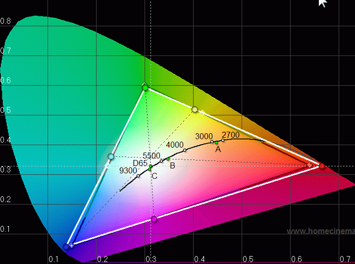

I measured my primaries & secondaries, and I'm a bit confused by what I see.
See the chart below. Magenta is nearly dead on, only off by 0.001 xy. Green is almost as good, off only 0.007. Red and blue are off a bit more (.025 & .012, respectively.)
What confuses me is yellow and cyan. If Green is almost perfect, and red is "too far out," then why is the yellow point off toward the green side? I would have expected yellow to be halfway between R & G. Would bringing the red in to its proper SMPTE C location bring yellow closer to red??
I assume you want the three dotted lines (between primaries & secondaries) to cross at D65. Mine don't, and I'm trying to decide what that means. Is the intersection point the place where the display **actually** displays 6500K white? If so, and if that intersection point isn't actually on the D65 point at 0.313/0.329, does that mean calibrating to .313/.329 puts you in the wrong place? Or does the colorimeter actually read .313/.329 at the point where the lines intersect, even if that isn't on the color-temp curve?
This probably won't change anything, since I can't fix the primaries or secondaries, but I'm curious...

Posted: Thu May 01, 2008 12:43 am    Post subject: Re: Primaries & secondaries
Yup - that's the way I understand it too. Mine go almost exactly through the D65 point.
Take at mine from my Zenith 1200/Barco Cine8 Onyx (LC with tinted c-elements on red/green):
You're using HD144 tinted lenses with tinted red/green if I'm not mistaken.
I've never thought about how accurate primaries are or are not, so I just spent a few seconds thinking about it and here's what makes sense to me:
The primaries are obviously measured with only one colour being displayed so the light output or brightness (luminance Y value) doesn't really matter. But when you measure secondaries, it's all about the Y levels of the two colours in addition to how accurate the primaries are. If the Y balance is wrong, then the secondaries will be wrong too even if your primaries are bang on
The primary and secondary patterns you used are window patterns just like the 0 - 100 IRE ones for setting greyscale right? Which means they're probably also 100 IRE window patterns. So what are your 100 IRE white window pattern x/y values? My guess is that you're not exactly at 0.313/0.329. Looking at your graph, your cyan point is closer to green than blue so at 100IRE your green level's probably higher than blue right?
At 100 IRE my xy values are 0.311/0.336 which gives a DeltaE of 6.6. Not bad but not super-great either. (Good enough IMHO). Can you post your chc file? I'd be curious to see it. I've uploaded mine if you want to look.
No, I don't see how that's possible. Otherwise your greyscale readings would actually show that wouldn't they? You'd measure and get readings that clustered around that new intersection point.
Understand it is important to knowing what's going on in case you need to fix something! Smile

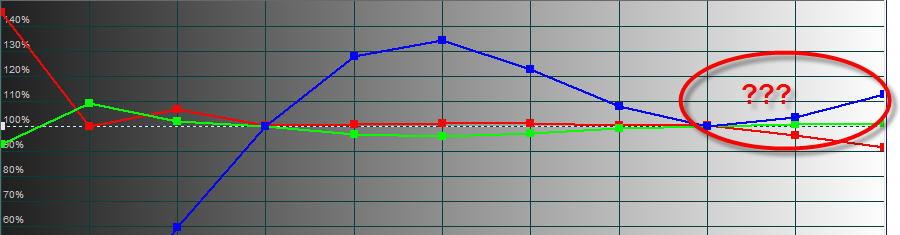

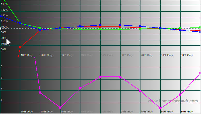

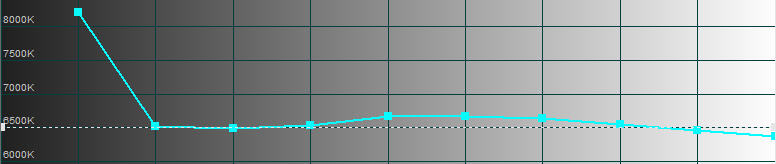

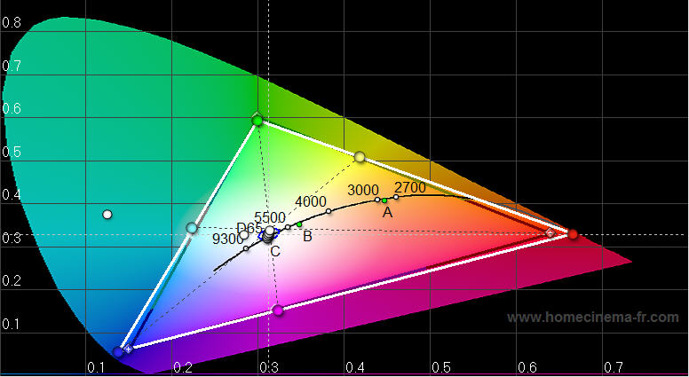

Posted: Sat May 10, 2008 11:44 pm    Post subject:
I did a more careful calibration on the full grayscale on my color-filtered Marquee. At first, after a touchup at 30%/80% but no blue defocus, I got a REALLY confusing display: my blue went UP at 90% and 100% !!? (First pic below.) I have NO idea what's up there.
So I defocused the blue a bit, and it looks much better. I still have a bit of a hump in the blue but not much, and I don't want to make the blue even fuzzier to fix that small hump. For the 8500 owners out there, my blue focus was at 47, though I think sharpest is actually about 50. I bumped it up to 59 for the final measurements.
DeltaE is 7.13 or below for 20-100%, color temp is 6374 at 100% but 6458-6668 for 20-90%. Gamma is actually a bit low (I have never gotten around to adjusting my Moome ext box) but I think I'll try it there for a while.
And now, with the grayscale correct, my secondaries are basically dead on. Smile
(The measurement dot waaay off to the left is IRE 0. That's way below what my colorimeter is capable of measuring, but I took the value it gave me. BTW these measurements were all done with my old Minolta TV2150, since the Spyder seems to be much less accurate. It's a pain to type in all the numbers but I think the result should be a lot better.)
Strangely enough, the final results show a bit of a hump in the RED. I didn't expect that. I've never heard of red overdriving the way blue does. I'm running the Marquee at 70 contrast (and still only getting 7.0 ftL off the screen, according to the Minolta!), but I don't think the red should be topping out. Anybody else seen humps in the red?

Posted: Sun May 11, 2008 6:48 am    Post subject:
Not bad at all Gary. Very nice. Similar to mine in that I can get everything from 20 to 100 nice but 10 IRE is off (no big deal).
Don't be afraid to defocus blue even more. If 50 is the sharpest and you're only at 47 that's nothing. For me, ~42 is the sharpest and I'm at 0. Yes, 0. If I put up a white crosshatch pattern you'll see blue halo's when standing up close to the screen but they're not visible at the seating position (12/13 feet back or more from my 8 foot wide screen).
Edit: That blue rise at 90 and 100 IRE in your first picture is very odd. Never seen anything like it. Weird!
Posted: Sun May 11, 2008 10:57 pm    Post subject:
No, sharp is at 50, I started out at 47, and I ended up at 59. 9 off is pretty significant for a Marquee. I haven't done a lot of viewing with it yet but I suspect the blue defocus might be noticeable at viewing distance on test patterns and credits.
I strongly suspect the wacky behavior at 0-10% is due to the colorimeter more than the projector. It reads 0.0 down there and the display flashes, indicating it's out of its range. (It's only rated down to 0.2 ftL.) 20% is 0.2 ftL so everything below that is questionable.
I've never been quite sure whether to believe the ftL measurements from this colorimeter. It says I'm only getting 7 ftL at 70 contrast, and I got similar readings with my XG and my G70. With just an 85" wide screen, I would expect more than 7 ftL even if it's slightly under 1.0 gain. Maybe if I ever get around to upgrading my screen I'll finally be able to get up to 9-10 ftL or so...
