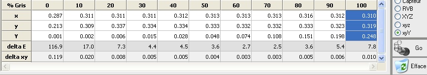

I have followed the guide to do some measurments, but I have an issue with the Y value (or Ftl).
Both x and y seems to be correctly captured (around 0.310 and 0.330 for all the grayscale) but the Y capture is far too low :
from 0.002 at 10IRE to 0.248 at 100IRE (so Ftl from 0.001 at 10IRE to 0.072 at 100 IRE).
Of course, this is not reflecting the reallity of my image, that is almost too bright (Panasonic AE8000, lamp in Normal mode).
Isn't there a scale issue, a matrix issue, or something like this ?
I have attached the measurments results if this can help.
PS : Your guide is really great !
Regards,
Cyriaque
Screen capture of the measurements tab.
I do not know what could cause causing this.
