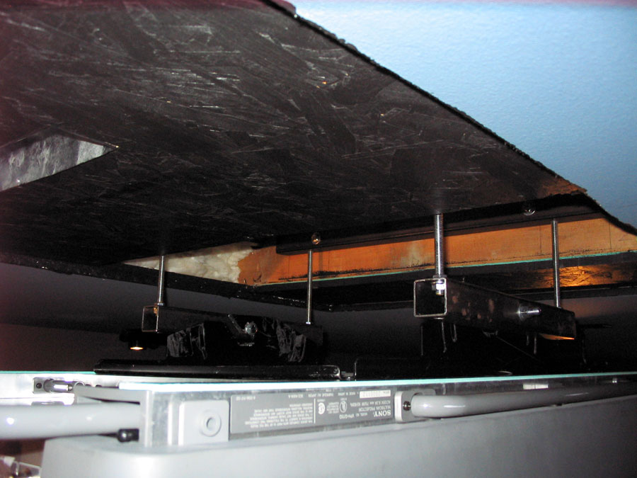

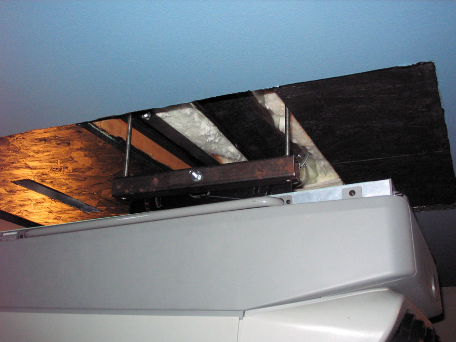

Here's a couple of pics of my mostly hand-fabbed mount before I cranked up the bolts to raise the projector up by turning the nuts at the top of the apparatus. Total time turning nuts one-by-one with a ratchet open-end was maybe 20 minutes.
It's all 1.5" square-tube mild steel, .375" all-thread, and grade 5 nuts and cap screws. The factory mount plate (THANKS RAY!!!) hangs on the cap screws attached to my horizontals. The two pieces the projector hangs on got rusty sitting out in the garage over the winter. Kinda ugly - wish I would have painted them. Oh well, nobody will ever see them after these pics. Wink

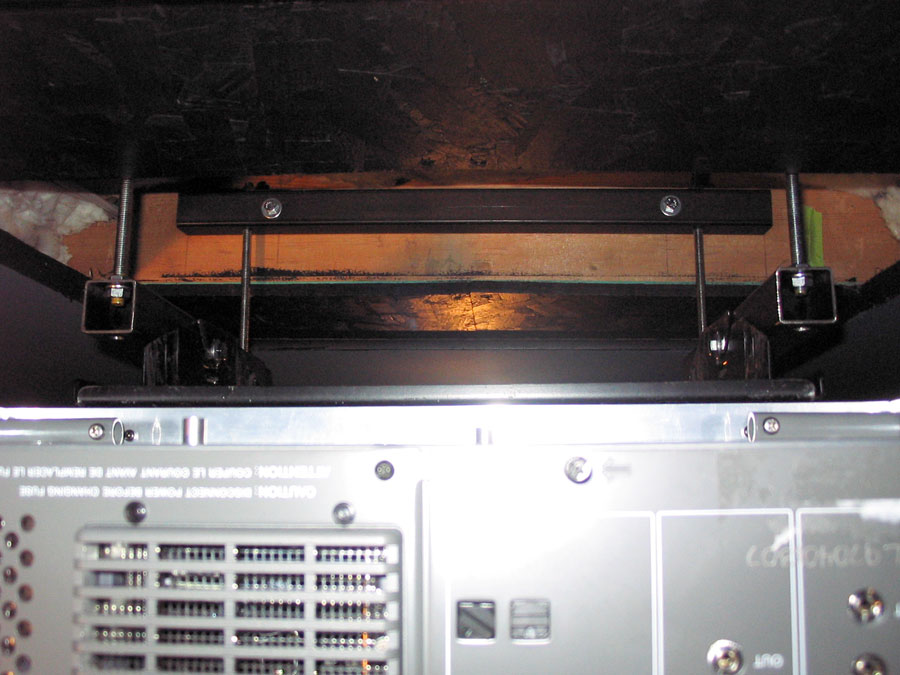

You can see the 2"x12" duct register at the back of this photo:

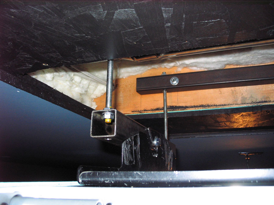

Connection details and factory mount plate: All-thread is a little deformed because the right side is high.
