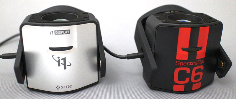

Both meters use the exact same X-Rite i1Display Pro hardware:
ChromaPure Display 3 PRO on the left (looks like the stock i1 Display Pro), SpectraCal's C6 on the right with the red stripe

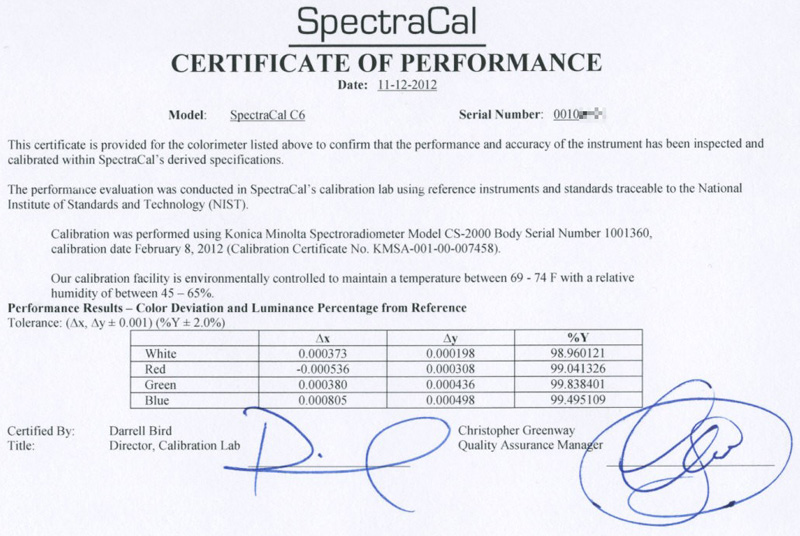

1. The corrections in the C6 are generic (the same corrections are used for all C6 meters), and thus do not accommodate meter-to-meter differences. Although this means that the C6 corrections can be upgraded in the field, it also means that they will be less effective because they are generic, rather than tailored to the specific meter. This is reflected in their documentation. The C6 comes with a general NIST certification that shows how far off your C6 is to the standard (these error corrections are not applied to your meter):
(Note that the C6 report states that a "Calibration was performed" when in fact the C6 meter itself is not calibrated at all. The certificate is to show that they deem the performance of the meter to fall within a tolerances range that they deem acceptable.)

4. X-Rite (the manufacturer) offers custom labeling at added cost to any reseller who chooses to brand the stock i1 Display Pro meter to suite their needs. The C6 includes such custom labeling (the red stripes and "C6") to brand their meter, while the the ChromaPure Display 3 PRO does not to keep costs down. The Display 3 PRO looks like a stock i1 Display Pro.
