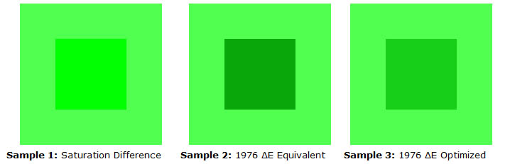

Consider the three green boxes below.
The first green box in Sample 1 surrounds a smaller green center that is more highly saturated. The difference between the high saturation center and the lower saturation surround is easily visible. In the middle Sample 2, the surround remains unchanged, but the brightness of the oversaturated green in the center has been reduced substantially. In Sample 3, the surround is again unchanged, but this time the brightness of the oversaturated green box in the center has been reduced, but to a smaller degree than in Sample 2.
These samples help illustrate how different ΔE formulae can yield quite different results. According to either of the 1976 formulas, the color difference observed in Sample 1 can be substantially lessened by lowering the brightness of the oversaturated color. Sample 3 roughly shows what the 1976 formula predicts is the lowest color difference achievable by lowering the brightness of the oversaturated center. These swatches are only approximations, but the theoretical model bears this out. Compare two shades of green, the Rec. 709 high-definition specification and an oversaturated sample:

According to the CIELUV color difference formula, the ΔE between these two samples is 23. If we do nothing more than lower the brightness of the oversaturated green to
x0.296, y0.676, Y0.540,
then, according to CIELUV, we reduce the color difference to just over 11. In other words, CIELUV predicts that a 25% reduction in brightness alone from this oversaturated green results in a 52% reduction in color difference between it and the Rec. 709 reference. This is what Sample 3 above illustrates. Even more startlingly, if you reduce the brightness even further to
x0.296, y0.676, Y0.383,
then the color difference is equal to what it was in the original sample. In other words, CIELUV predicts that a 48% reduction in brightness alone from this oversaturated green has no effect on perceived color difference between it and a Rec. 709 reference. This is what Sample 2 above illustrates.

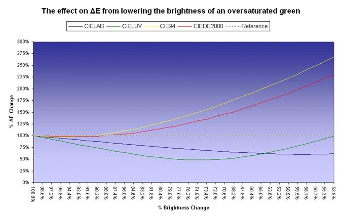

The interesting aspect of this is that the more recent ΔE formulas-CIE94 and CIEDE2000-predict something very different. Consider Figure 3 below, which shows the effect on color difference between a Rec. 709 reference (of x0.300, y0.600) and the same oversaturated green (x0.296, y0.676) as brightness is lowered from a reference level of Y0.715 to Y0.383.
This graph shows that the 1996 and 2000 ΔE formulas predict very different results from either of the 1976 formulae. According to either CIE94 or CIEDE2000, reducing the brightness of an oversaturated green (the effect is similar for red) is a counterproductive method for reducing color error. In contrast the 1976 color difference formulas (CIELAB or CIELUV) predict that reducing brightness from an oversaturated sample 35% lowers ΔE by approximately 31%. However, CIE94 predicts that reducing color brightness this much for the same color nearly doubles the color difference! The CIEDE2000 prediction is only slightly less dramatic.
