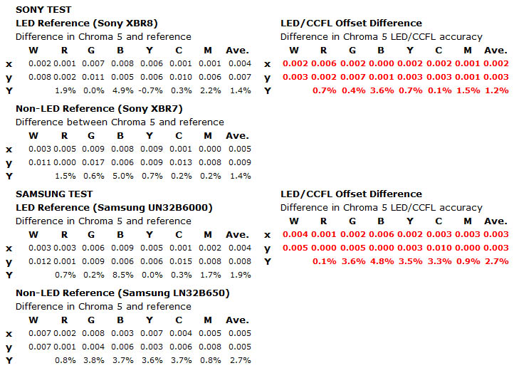

Recently, we conducted some careful tests under controlled conditions to determine what, if any, special attention the Chroma 5 would require for measurements of LED-based displays. We used two pairs of displays, the conventional Sony XBR7 and the LED-backlit Sony XBR8. We also tested the conventional Samsung B650 and the LED-backlit Samsung B6000. We chose these displays because they represent mainstream popular choices among consumers and the displays in each pair were as similar as possible to each other except one used conventional CCFL backlighting and the other used LED backlighting. Then we measured the entire spectrum of white, red, green, blue, yellow, cyan, and magenta on all of the displays with a reference 5nm spectroradiometer and then with a factory-fresh Chroma 5 colorimeter. Finally, we compared the differences between what the reference device measured compared to what the Chroma 5 measured. If the Chroma 5 had any special difficulty with the LED displays, then we would expect to see a significantly larger discrepancy between what the reference instrument reported and what the Chroma 5 reported on the LED displays than we would see between what the reference instrument reported and what the Chroma 5 reported on the conventional displays. The results are shown below.
The xyY values on the left in black show the accuracy of the Chroma 5 on these four displays. The xyY values on the right in red show the differences in accuracy between the Chroma 5 on the LED display compared to the conventional LCD display.
As you can see, the differences between the reference instrument and the Chroma 5 are generally quite small, indicating that the Chroma 5 is an excellent colorimeter. You can also see that the Chroma 5's accuracy when measuring LED and conventional displays is virtually the same. In fact, to the extent that there is any difference at all, at least with the Sony displays, the Chroma 5 was actually somewhat more accurate (x0.004, y0.007) when measuring LED-based displays than it was when measuring the conventional LCD (x0.005, y0.009). With the Samsungs, the Chroma 5 was slightly less accurate overall with the LED display (x0.004, y0.008) than it was with the conventional LCD display (x0.005, y0.005). On average, the errors in luminance were negligible.
When comparing the differences in accuracy between the Chroma 5 on conventional displays and its accuracy on LED displays we can see that the differences are very small and on average they are below the threshold of visibility.
The evidence is pretty clear. A standard Chroma 5 colorimeter does not perform significantly worse on LED-based LCD displays than it does on conventional LCD displays and may even perform slightly better.
