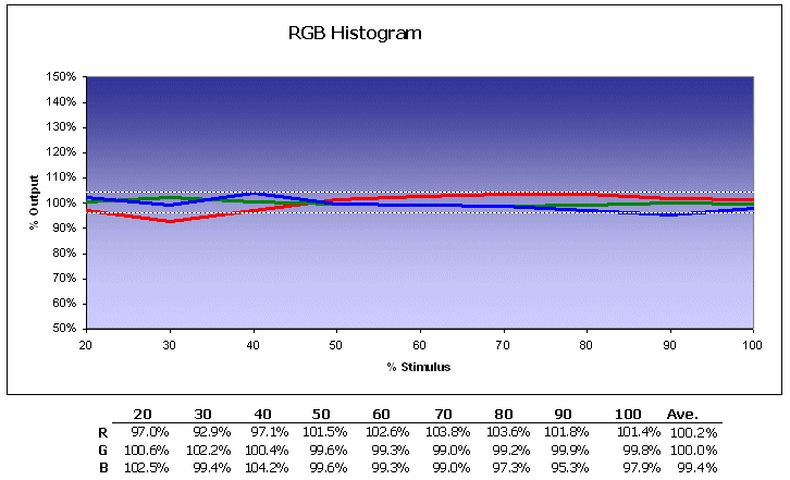

Another way of representing grayscale performance is with a RGB histogram. Since white is simply the combination of all colors and all color is merely combinations of Red, Green, and Blue, neutral white is achieved when there are equal mixes of RGB. This can be easily plotted on a chart that shows how the mix of RGB changes throughout the grayscale. The closer any point on the grayscale is to to a perfect blend of 100% red, green, and blue, the more accurate the color of white at that level of stimulus.
The counterintuitive aspect of calibrating a display's gray scale is that you are actually trying to remove as much color as possible. It is only when the entire range of brightness is a completely neutral gray without any color contamination that the display will present ONLY the color provided by the source. Otherwise, the display introduces its own color cast to the image, which can make it look very unnatural.

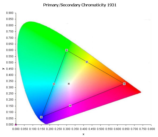

The most common way that the gamut is represented is through a triangular-shaped chart, known as a CIE chart, which is shown below. CIE stands for Commission Internationale de L'Eclairage or "International Commission on Illumination". This organization sets international standards for color reproduction.
On this chart the colored, tongue-shaped area represents the entire spectrum of visible color. The black triangle inside represents the gamut used for high-definition programming. As you can see, the gamut used by content developers is considerably smaller than what the eye is capable of seeing. However, there are wider gamuts that use more of the available color space, such as the gamut used by the Digital Cinema Initiative. However, this gamut is not used for the development of content intended for home viewing, so it should not generally be used as a calibration target.
The further the measured colors deviate from their intended points on this chart, the less accurate the gamut.

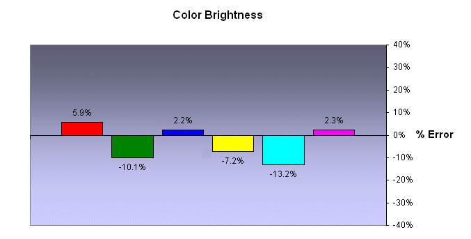

Brightness: This is the luminance of the color, literally how bright it is. This is the characteristic of color that is not depicted on the CIE chart at all. Thus, we need some other method to portray this. A standard bar chart is well suited for this task.
The brightness of the color is not a fixed property like xy coordinates on a graph. The xy coordinates can be used to describe the saturation or hue of a color, but not its brightness. For that, we use the uppercase Y symbol. The brightness of any color is generally understood as a proportional relationship. Specifically, it is relationship between the brightness of the color and reference white at the same level of stimulus. The established HD reference for this is:
