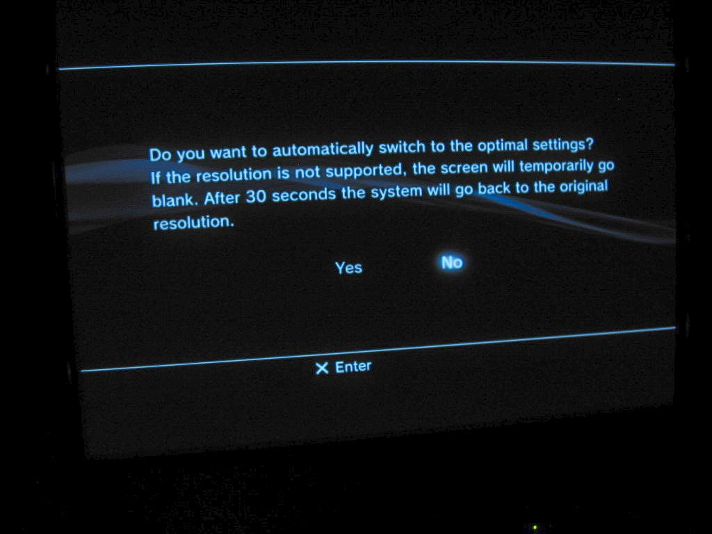

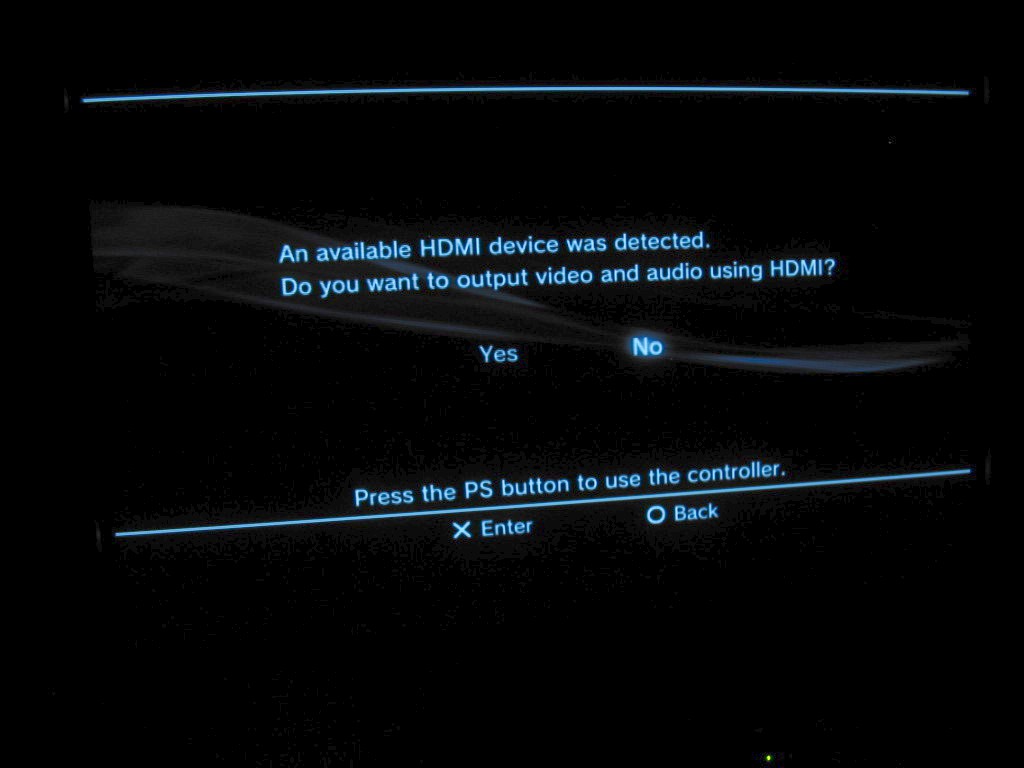

You will get a message that says:
"An available HDMI device was detected.
Do you want to output audio and video using HDMI?"
Say Yes.
It will ask you if you want to switch to Optimal settings say NO
You will then see your screen on the HDFury at 480P

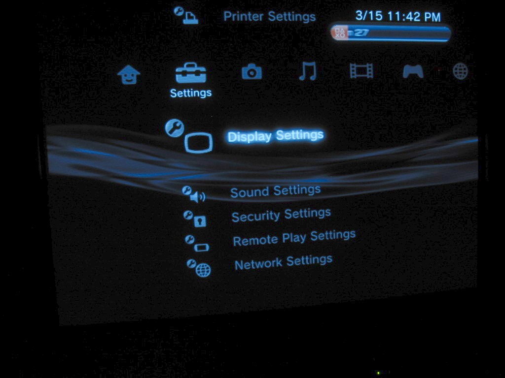

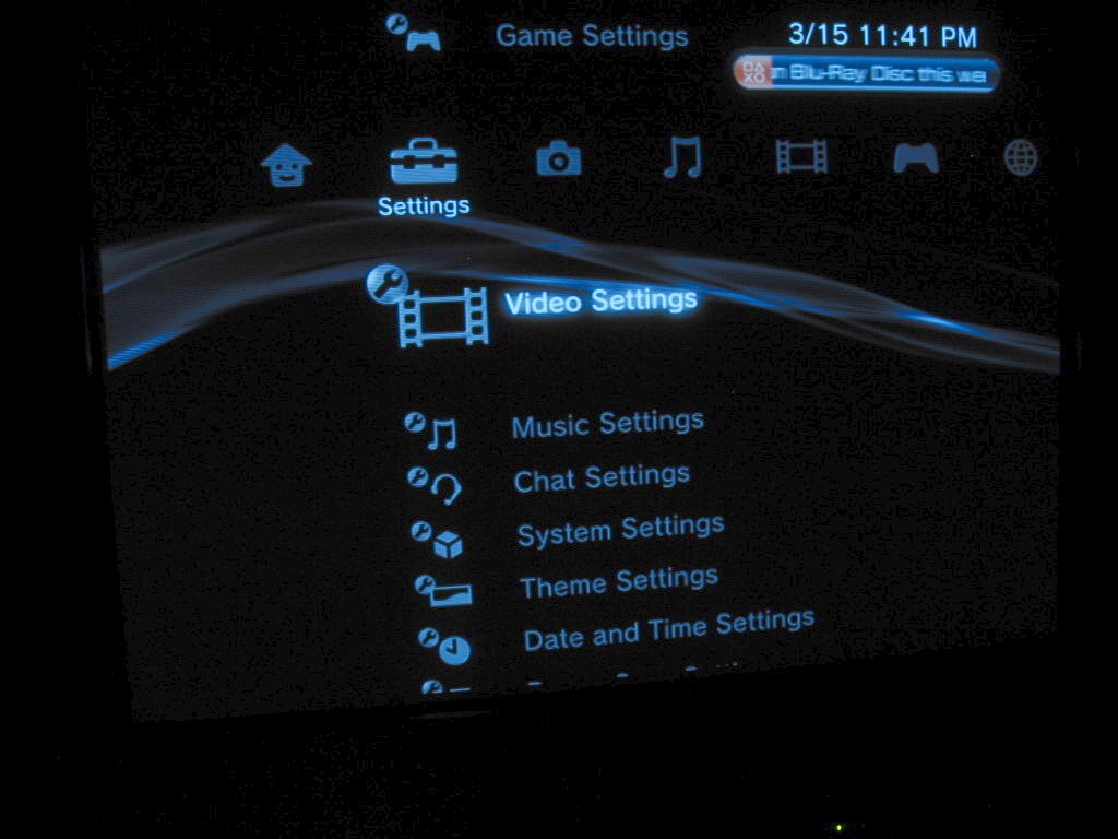

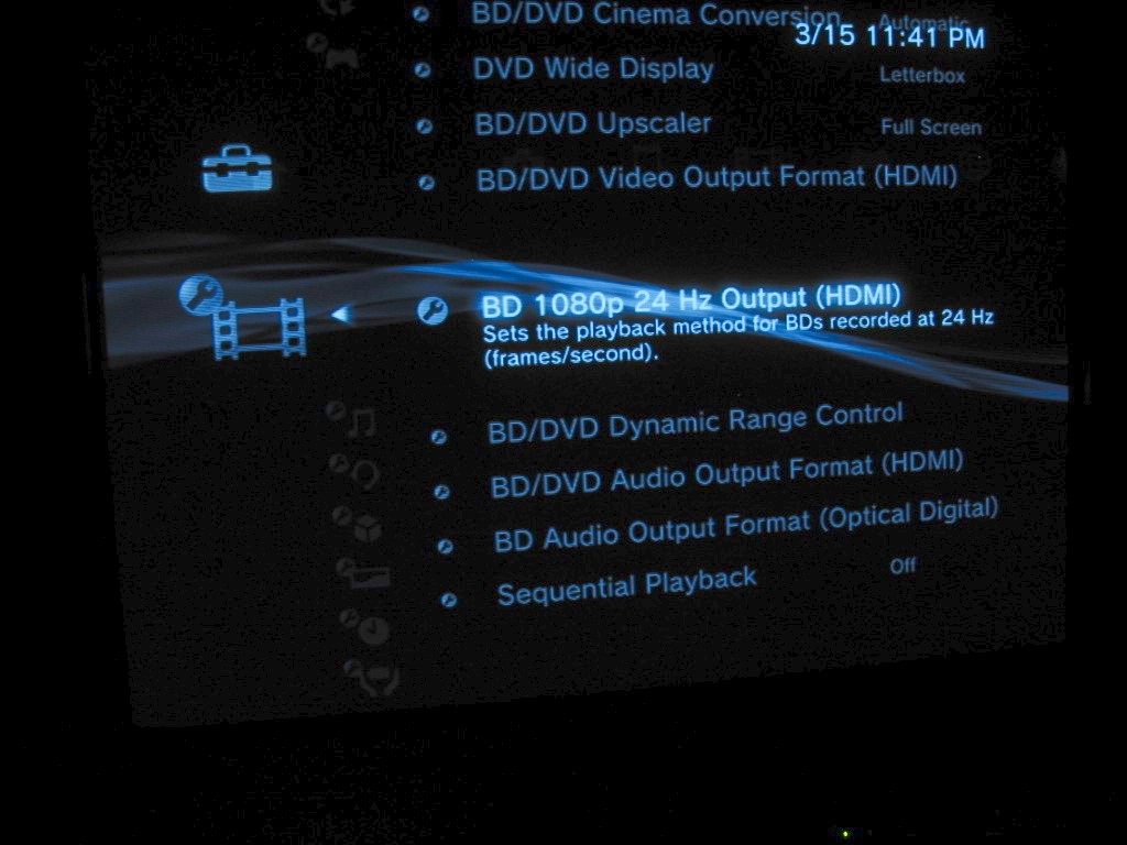

Goto Settings--> then Video settings,

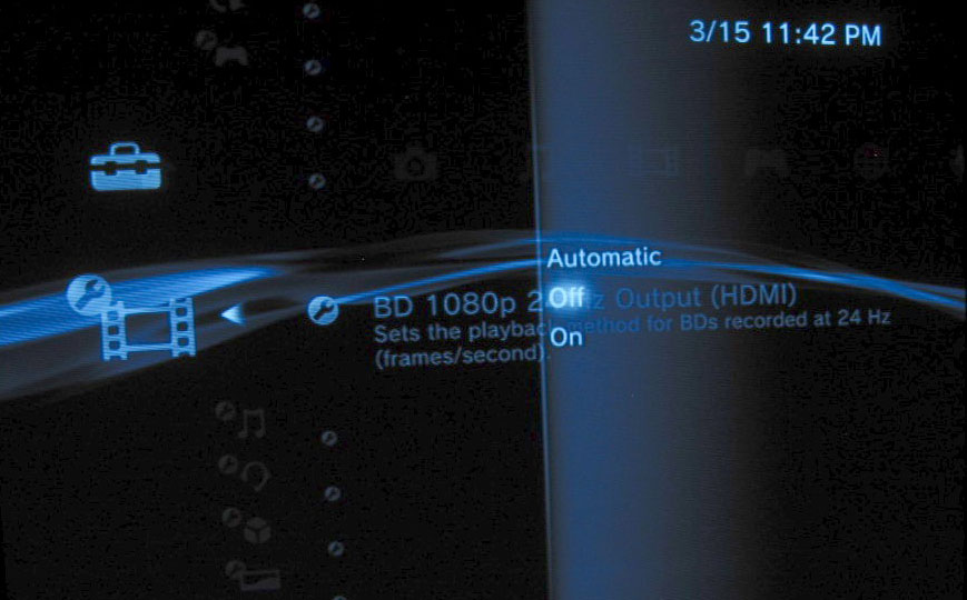

scroll down to "BD1080 24Hz output HDMI"
Change this from AUTO to OFF
Push the "x" key to save

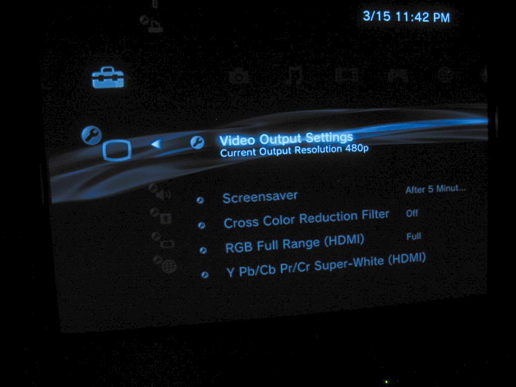

Go back to "Video Settings"
Scroll down to Display settings hit 'x'.

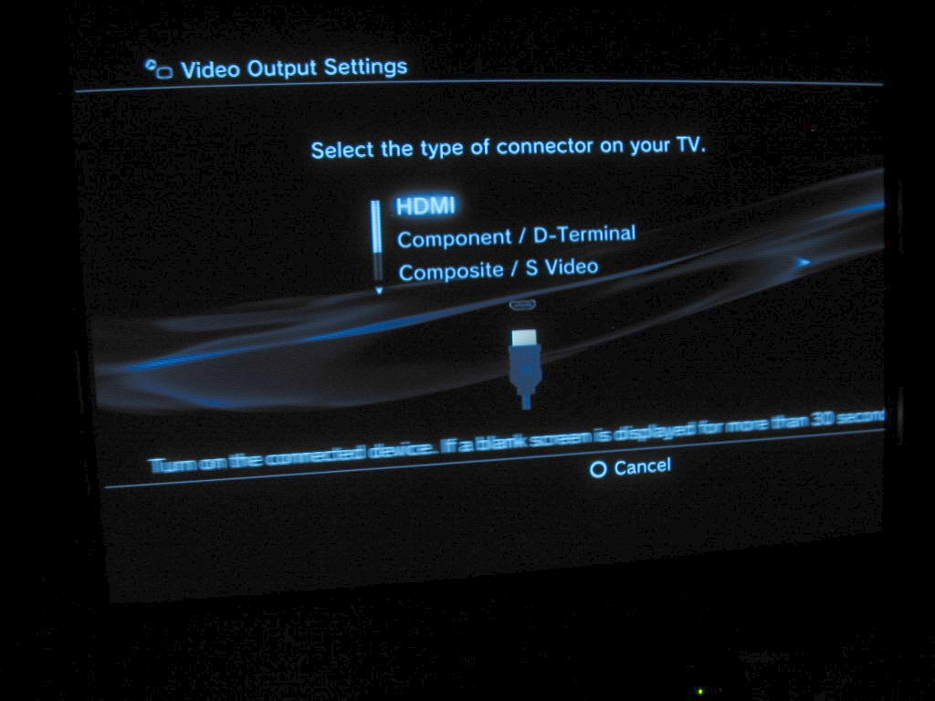

Video output settings HDMI

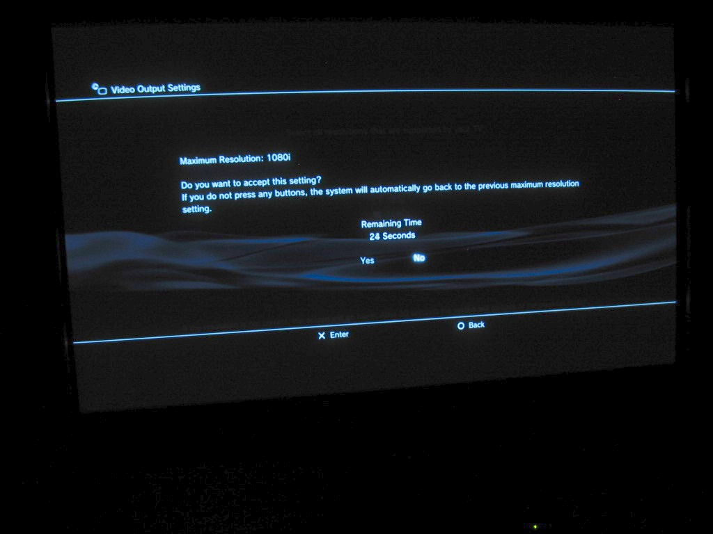

Select the resolution you need for your display

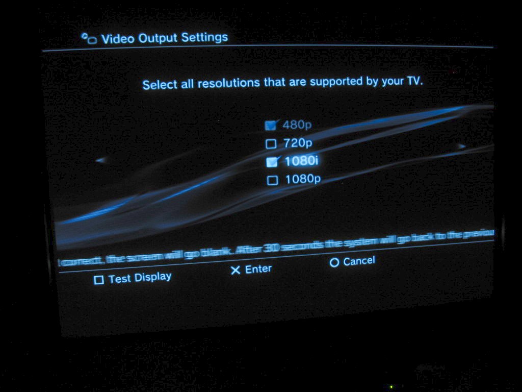

Check off 1080i or 720P. Then push the joypad to the right to set your highest setting.
Max resolution

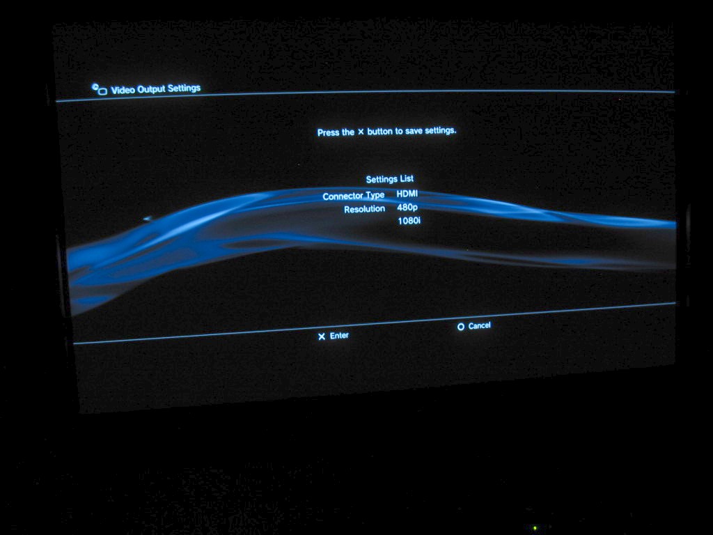

Do you want to accept? Say YES

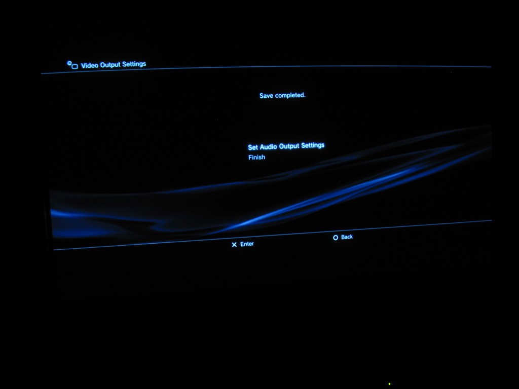

Press 'x' to save settings

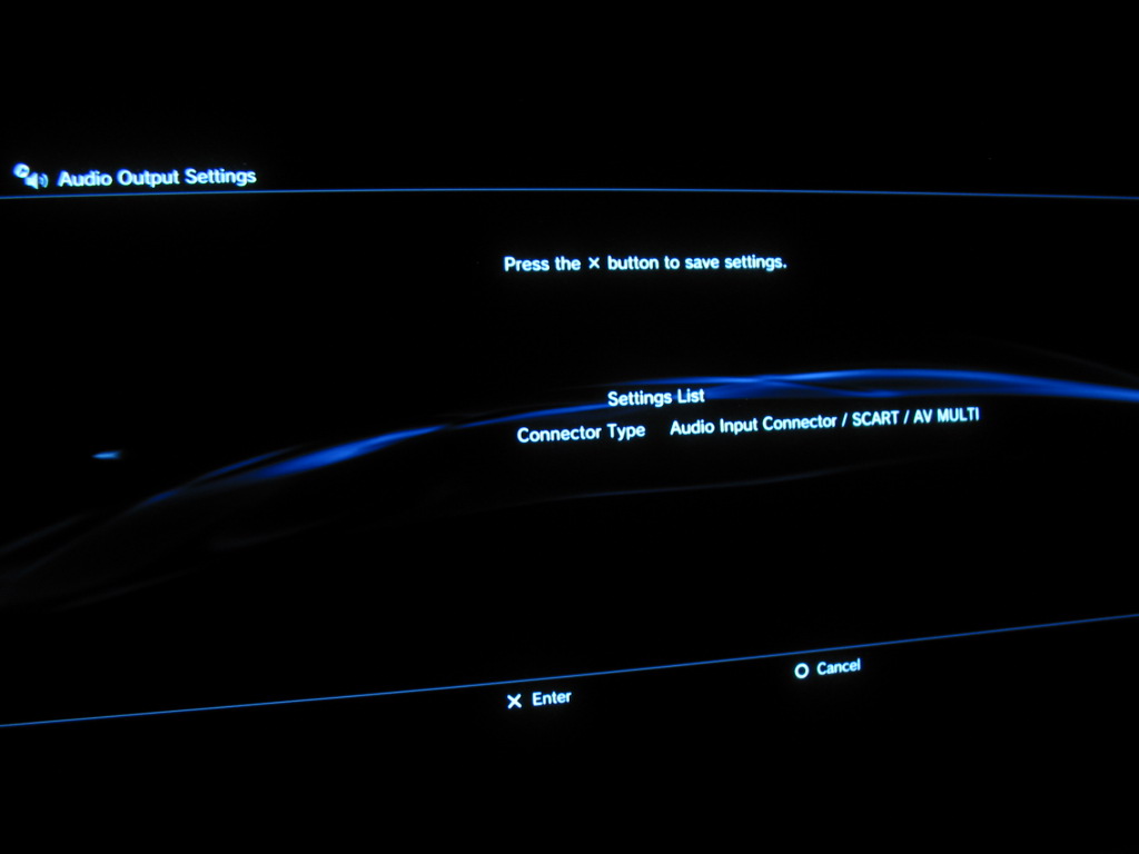

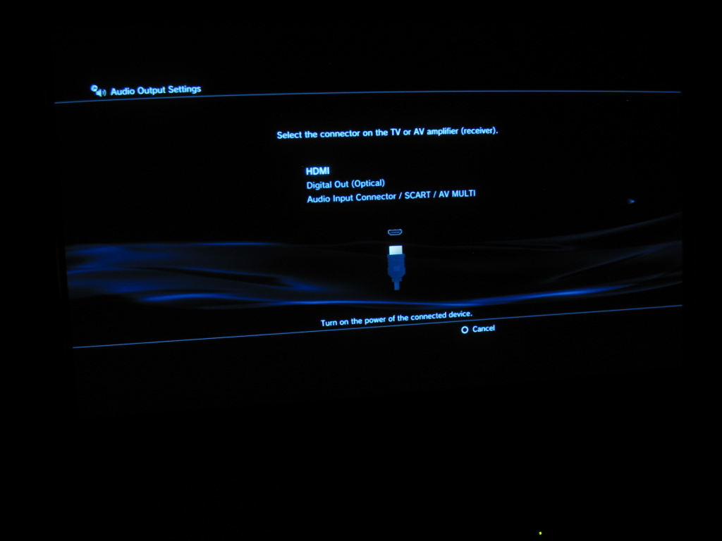

Set your audio output in the next step. Your options are:
Audio over HDMI ( use this if you are ouputing audio to a receiver via HDMI ),
Audio over optical ( use this if you are using a digital optical audio connection to your receiver) or
Audio over AV cables or SCART (Use this for 2 channel audio analog output).
Now select the connection you need for audio output
Press 'x' to save
