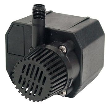

Speaking of glycol, I don't actually use it - I'll use the same stuff as on my old bar setup which is RV/cottage antifreeze. It's a liquid that you're supposed to pour into your toilets in the RV or cottage for the winter to stop them from freezing. It's drain safe.
My total run is under 15 feet so a container in the serving keezer with a simple little pond pump will be used to recirculate.
The keezer set to above freezing doesn't actually chill the antifreeze enough so a loop of copper will be placed in a freezer that's well below freezing to allow it to chill adequately as it recirculates. This is the same freezer that I'll be using to store hops and yeast. It'll a very small freezer.
This is the pond pump that I used before on my previous setup and will continue to use:
Link: http://www.amazon.com/gp/product/B00002N8GS/ref=as_li_ss_tl?ie=UTF8&tag=theelectricbrewery-20&linkCode=as2&camp=1789&creative=390957&creativeASIN=B00002N8GS
Since my line length is only 15' I don't need a massively powerful pond pump. The one above worked fine before with a similar length of 1/4" glycol line plus about 20 feet of copper coil in the freezer. This time I'm going to use bigger 3/8" line so there should be even less restriction. The pump ran for 5+ years straight, 24 hours/day, 365 days a year. That's what they're meant to do. No issues.
To get the antifreeze to and from this freezer, the glycol tubes in the main trunk are cut and spliced to a second line with only the glycol shooting off to a freezer. So I ordered 10 feet of this glycol only trunk line:

In my case, the distance between the taps and the kegs was designed to be as short as possible, only about 10-15 feet (one of the design goals of the basement) so a "real" glycol chiller isn't required. I wanted to avoid using a real glycol chiller because:
- They're loud
- They run hot
- They use a lot of power
- They're expensive (around $1000 instead of $40-$100 for a pond pump)
In my case, with a short run I'll be able to use a simple $50 pond pump to push glycol through a 3/8" ID copper coil in the freezer. This is what I did in the old bar setup and it worked very well. So well in fact that in humid months condensation would form on the taps:
