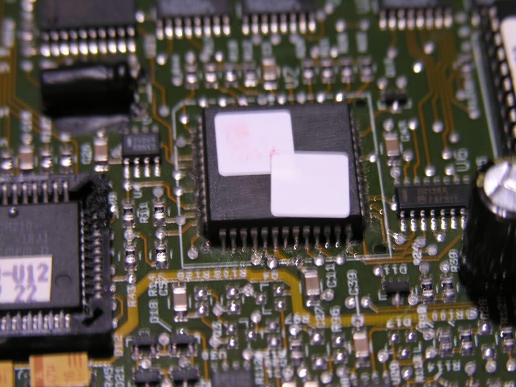

I pulled out the control module. That chip has labels over it that say "Madrigal 5.6"; it was modded by Hi-Rez last May. Unless I'm missing something it looks like that chip is soldered in place (and some very delicate soldering it was).

This is a photo of one of the dots
This appears to be the U7 chip; which doesn't look like an easy task to remove or re-attach
What is that????? U7 is always in a socket so it can be upgraded by swapping later.

Tim, Some of the later Marquee's have soldered U7 chips. I know of some who have mentioned they have soldered in Chips on the CLM, not only U7 but others as well.
