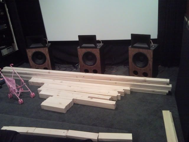

PostLink    Posted: Sat May 29, 2010 4:05 am    Post subject: Reply with quote
Got all the 2x4's cut today and transported downstairs...will have to piece this together as naps line up with my motivation.

Posts: 6950
PostLink    Posted: Sat May 29, 2010 12:39 pm    Post subject: Reply with quote
Is that your hand truck on the left for moving those boards? Laughing

greg_mitch
Posts: 5198
PostLink    Posted: Sun May 30, 2010 4:30 am    Post subject: Reply with quote
Sometimes I feel like that is the quality of tools I am using..but I realize it is mostly user error. My daughter has been very helpful measuring boards with me before I make cuts.
