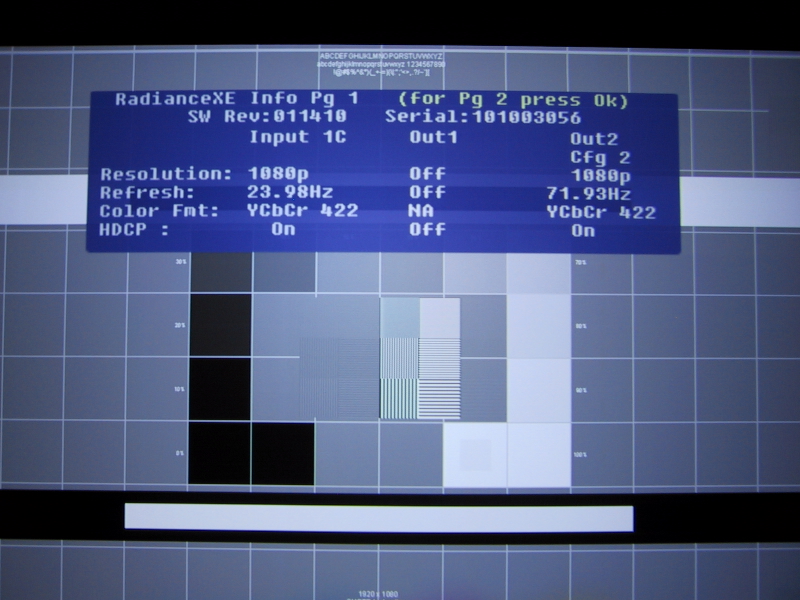

I just love posting this photo... G90 running 1080p @ 72Hz and doing it very well Embarassed
