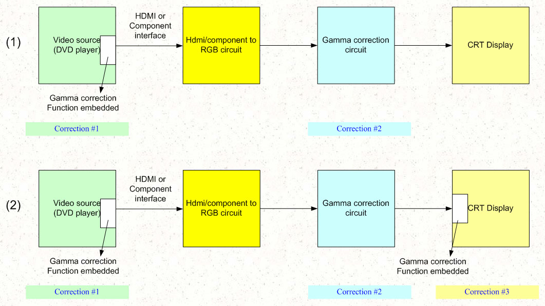

There are basically 3 ways to add a gamma boost to the signal. In the source device (1), as an add-on box or card of some sort (2), or a CRT projector that has gamma correction circuitry built in (3) (see below):
To get a near-perfect linear response, it's possible to apply gamma correction at multiple points along the signal chain as seen below:
