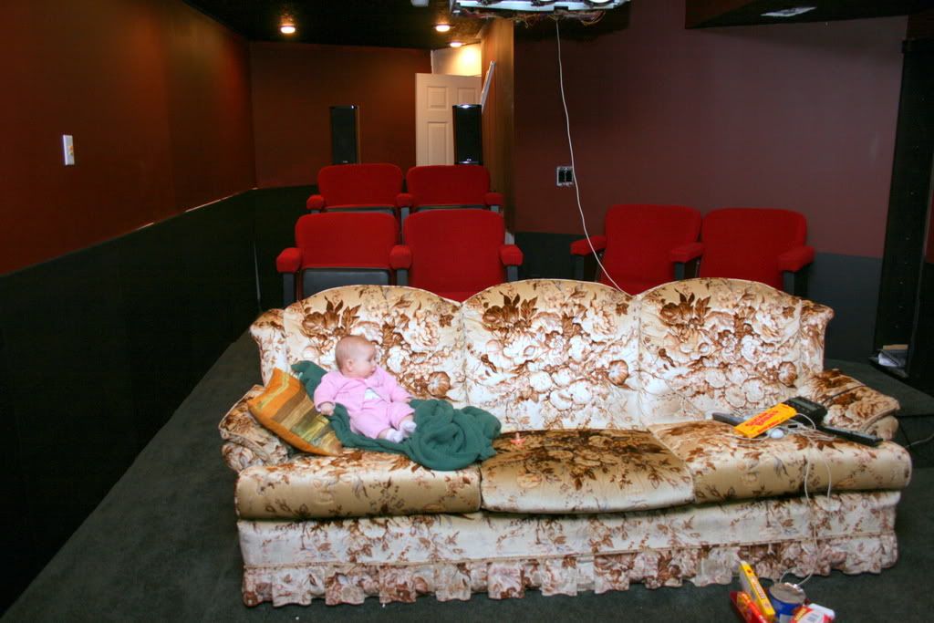

Hopefully this is not the final spot where the two rear speakers are going to go? It's got to sound a bit odd as they're both together and *RIGHT* behind the people at the back. They're going to be way too loud for them while the fronts will be too quiet. The reverse will be true for the front couch.
If this was my setup, I'd stick them high up on the side walls and face them up or to the back of the room or something. If movies are what you're setting up for, you want a diffuse sound field.
I could never actually get a nice diffuse sound field with direct radiating speakers so I got dipole/bipole speakers.

Believe me, I know! I am open to suggestions. I purchased some of those cheapy Insignia for side surrounds but I was contemplating bipole/dipoles for some time. I could never justify the cost.
One of my other options was to put ceiling speakers near the back row but that isn't ideal for the front row either.
I had to work with the obscenely strange shape of my room, which didn't help things.
i might try to pick up some of those Bic Acoustech dipoles on eBay for like $180 and then sell my other two sets of rear and side surrounds.
What do you guys think? The layout of the room is this...

I'd keep the speaker you have. Just find a way to get them up high maybe on the side walls, pointing at each other or anywhere other than at the listeners. Maybe near the display case on the left and adjacent on the right wall, pointing backwards are something.
You can try temporary setups with ladders or something else to get them up high. I have an odd-ball shaped room and I played around with half a dozen places before figure out where to anchor them.

I am still open for dipoles due to their reduced footprint as these Onix Rocket RS150's are pretty stout for rear surrounds (at least from what I am used to). I want some wall mountable speakers as opposed to get some sort of wall bracket stand and then just resting these speakers on there. Once I got the Insignia's I realized they were too big as well. They will work nicely in the garage though! I don't know if these are worth a sh*t but they look decent...
I would like some Onix Rocket RSS300's or Axiom QS4's but they are considerably more. Really just working off of budget at this point.

Hey Greg, what's behind that angled wall? I couldn't tell from the pics. Is it your mechanicals room? Just curious.
Greg

Yep, furnace, water heater, water softener, etc.
I actually had contemplated moving some stuff around at one point but then realized that if the room was already constructed I would just take advantage of that little space and make do.
My next house will have a better layout I can guarantee. Maybe within 5 years!
