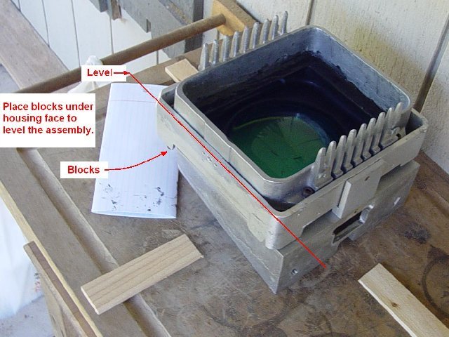

10.j Once you have a complete smooth layer of silicone on the mounting surface, place some blocks under the housing face so that the mounting surface is level. (Picture 10.j)
Picture 10.j.

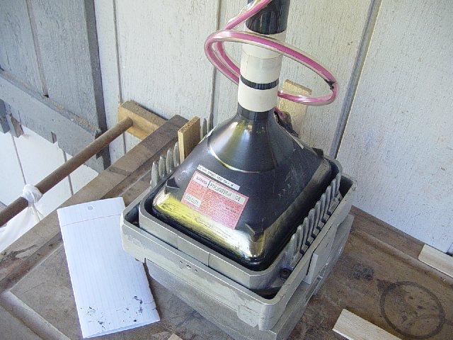

10.k We will now be mounting the tube into the housing. It is important to make sure the tube is centered during mounting. Any significant tube adjustment after setting will smear the silicone on the tube face, which will reduce some useable phosphor area. To help minimize tube adjustment, I glued two of the shims (ref step 10.d) to the housing. A little dab of silicone on the shims will hold it in place. (Picture 10.k)
Picture 10.k.

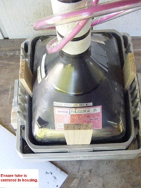

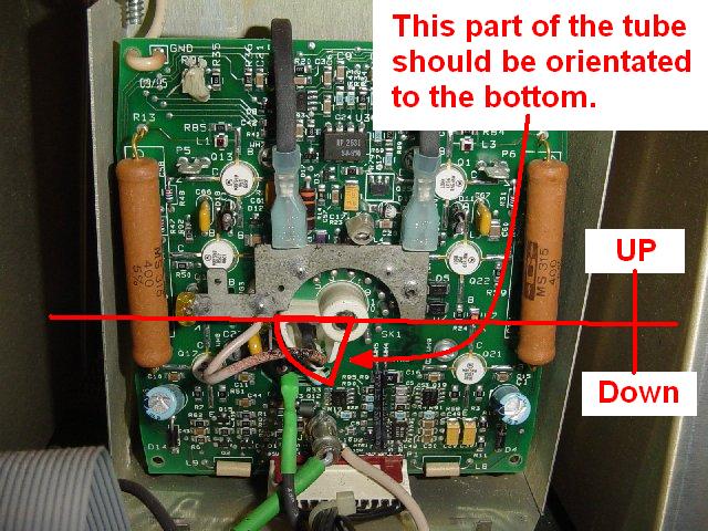

10.L Be sure not to install the tube upside-down. If you install the tube upside down, you will not be able to connect the cables to the neckboard. Looking at the neckboard connection, the triangular part of the connection needs to be down – not up. (Picture 10.L)
Picture 10.L.
10.m Carefully set the tube down into the housing. Maintain slight pressure from the tube against the two-glued shims to help ensure the tube is centered when lowered into the housing. (Picture 10.m) After the tube is completely set in the housing (and silicone) place the last two shims in place.
Picture 10.m.

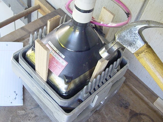

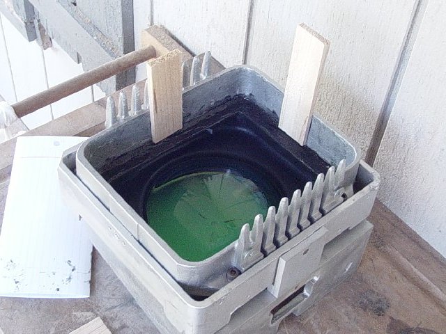

10.n Lightly tap the shims down to lock/wedge the tube in place in the housing. (Picture 10.n.1) Ensure the tube is centered in the housing. Allow the tube silicone to cure (approx 1 day) (Picture 10.n.2). Store silicone tube to be used later.
Picture 10.n.1.
Picture 10.n.2.

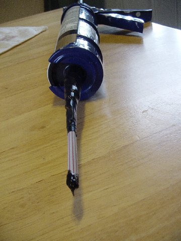

10.o After silicone has cured, remove shims, and get silicone tube ready for continued use. Take a typical drinking straw, cut it to 4-6 inches long, and tape the drinking straw onto end of the silicone tube nozzle. …Use plenty of tape. (Picture 10.o)
Picture 10.o.
10.p Apply more silicone to the housing to fill the housing/tube gap. To ensure a complete filling of the gap without air pockets, use the straw to fill the gap starting at the bottom until the gap is full of silicone.

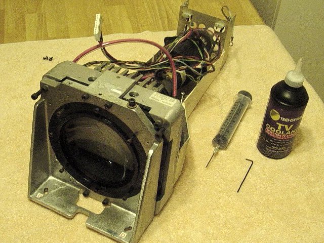

11 Filling your new tubes with Glycol:

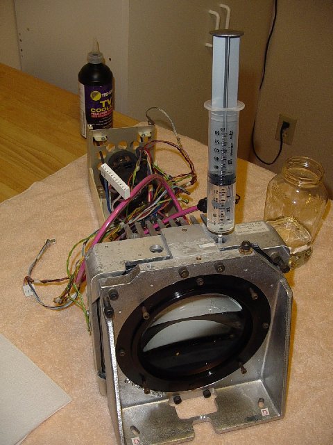

11.a After silicone is cured, remove both fill screws and fill the tube chamber with glycol coolant. To get the glycol in the very small fill holes, I used a (very) large syringe that I bought from a veterinary clinic (the vet cares for large farm animals). The syringe I used was a 2oz syringe with a 14 gauge x 1.5-inch long needle. I used just under 20 oz of glycol per tube. When finished install both fill screws. (Picture 11.a.1, Picture 11.a.2)
Note: It’s recommended to leave a little air in the glycol chamber for fluid expansion when it heats up, (or when the glycol absorbs water from the air over the course of a few years). As the glycol heats up and expands - it will apply pressure on the C-element, tube, and bellows. With enough pressure, a leak or other damage may occur. The air bubble will allow some room for expansion and will help against any damaging pressure build-up.
Picture 11.a.1.
Picture 11.a.2.
