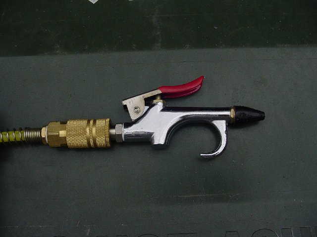

8.d.1 Start-up your air-compressor and have an airgun attached. Preferably a rubber tip nozzle. (Picture 8.d.1)
Picture 8.d.1.

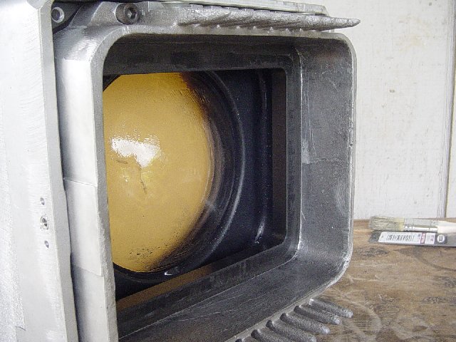

8.d.3 After completely flushing the housing, take the housing and rinse using hot water. (I used the kitchen when the wife wasn’t looking.) Keep rinsing until the aluminum housing and C-element assembly is about the same hot/warm temperature as the hot water.
8.d.4 Take the (hot/warm) housing to the air-compressor. Hold the housing assembly so that the C-element is horizontal and any water on the C-element would drain away from the center to the edges. (lens side down, tube side up.) (Picture 8.d.4)
Picture 8.d.4
8.d.5 Use the air nozzle and blow-dry the assembly. Hold the air-nozzle at least 6 inches away from the housing. Blow-dry the majority of the housing dry and then concentrate on any remaining water on the C-element. If any water remains on the C-element, blow the water to the edges of the C-element. The idea here is to ensure no water stays on the center of the C-element and dries. This could possibly leave water spots in the middle (most visible area) of the C-element. Do not try using towels to dry the C-element as towels leaves a lot of lint, and the C-element scratches fairly easily.

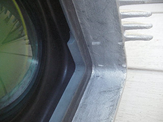

8.d.6 You should now have a clean housing & C-element. (Picture 8.d.6)
Picture 8.d.6.

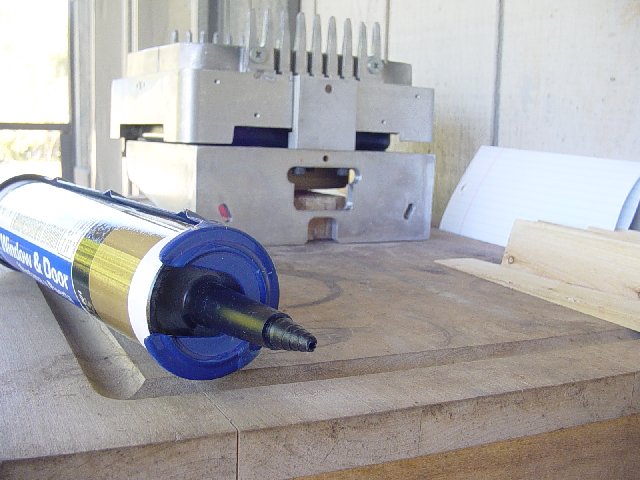

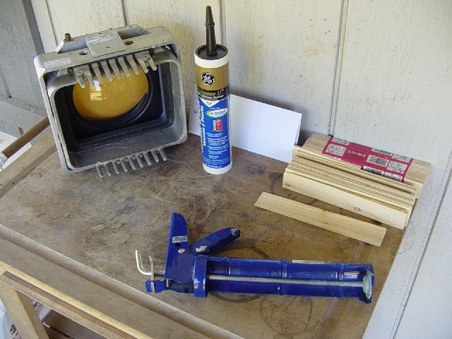

10.a Collect your supplies, you’ll need: 1) your new tubes, 2) 1 tube of GE silicone II Black Window and Door Silicone Sealant, 3) caulk gun, 4) some unused paper [notebook or printer paper], and 5) 2 packages of wooden shims (optional). I used typical wooden shims used for door & window installation. (Picture 10.a)
Picture 10.a.

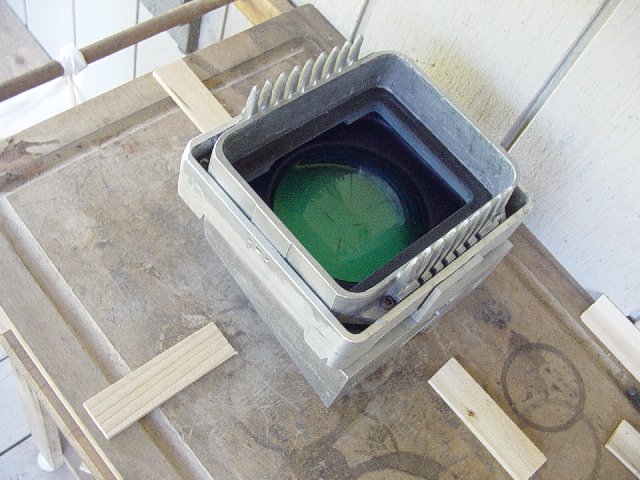

10.b Use some small blocks of wood to place under the housing so that the mounting surface will sit flat on your workspace. We will be mounting the tube soon, and want the tube to be mounted on a level surface.

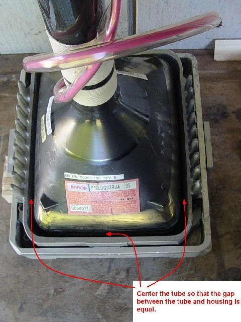

10.c Dry fit the tube in the housing. Place the tube in the housing and adjust the tube so that it is centered and all gaps are equal. (Picture 10.c)
Picture 10.c.

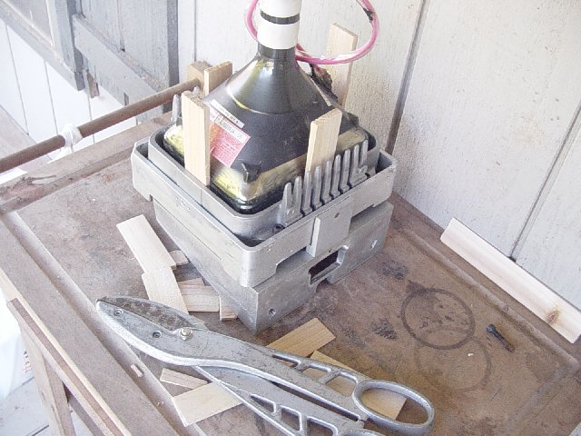

10.d Trim the shims so that they fit snugly between the tube and housing and they maintain the gap necessary to keep the tube centered. (The shims will hold the tube in place once the silicone is used.) (Picture 10.d)
Picture 10.d.
10.e Once the shims are cut to size, remove the tube, and keep the shims in their respective locations. (Picture 10.e)
Picture 10.e.

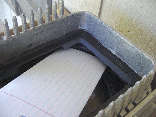

10.h Take some paper and tri-fold it like a folded letter. Take the paper and insert it over the C-element and into the bellows. This should protect the C-element from accidentally getting any silicone on it. (You don’t want that to happen, but if it does occur – I suggest using lots of clean soft dry Q-tips to remove the silicone. If you try using paper-towels, use caution as the C-element can easily be scratched even by paper-towels.)
10.i With the paper covering the C-element, apply a layer of silicone to the mounting face of the housing and smooth out the silicone to a uniform thin layer. Move the paper as required to protect the C-element. (Picture 10.i)
Picture 10.i.
