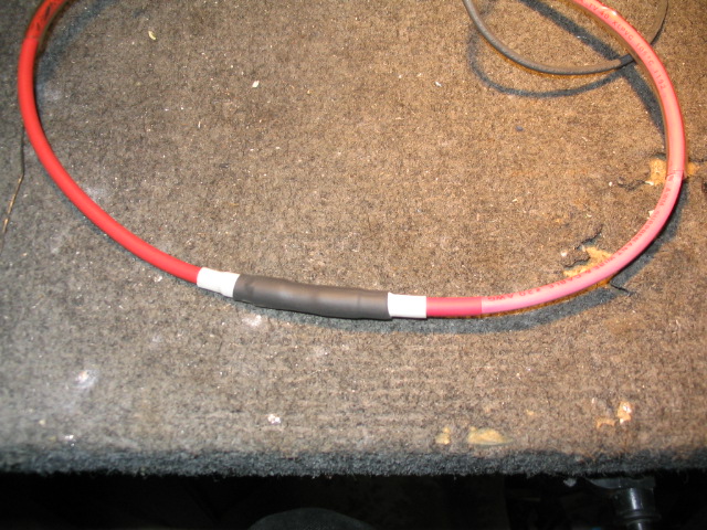

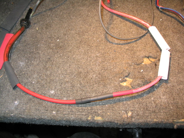

Place the layers of heat shrink over the splice point and shrink each piece of tubing individually (see image below):
When you’re done, you’ll have multiple layers of heat shrink tubing over the splice point and the connection and insulation will be as solid as the original lead itself (see image below):
